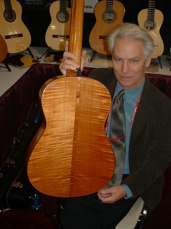

By'golly! Here it is!
PostPosted: Fri May 19, 2006 5:26 am
You forgot to put "image stolen from LMII.com" on that pic.
PostPosted: Fri May 19, 2006 7:06 am
Serge DeJonge built an entire guitar out of spanish cedar - everything except the bridge and FB. I think guitargal had it a couple years back, it was all curly.
PostPosted: Fri May 19, 2006 7:11 am
Looks like Kenny Hill.
Raj, I think Spanish cedar isn't used much for guitar bodies simply because it isn't offered much in appropriate sizes by vendors. SC is much like mahogany in character, but it's a bit lighter in weight and a bit less stiff. It should make a great sounding tonewood, and it would smell incredibly good.
